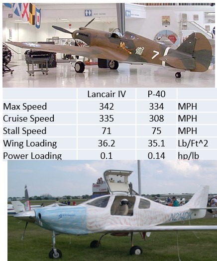

What do I think is wrong with the Lancair IV? Simple: Every aircraft design is a result of compromises, and in the Lancair IVās case, most of those compromises were made in favor of high cruise speed. This invariably means danger in the other portions of the performance envelope. Itās part of the trade for going really, really, fast.
Compare the Lancair IV to the Curtiss P-40 fighter.
Note that the specs are nearly identical. The P-40, like the Lancair IV, are not planes to be taken lightlyā¦
